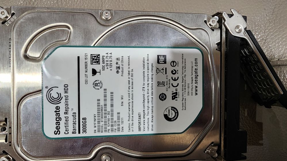

    It could certainly be one or more of the drives, but you can't rule out the NAS power supply at this point.
    It'd be helpful to know exactly what drives are installed.  Perhaps post pictures of the labels on them?

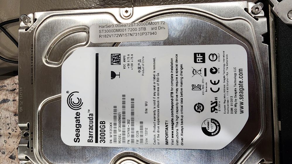

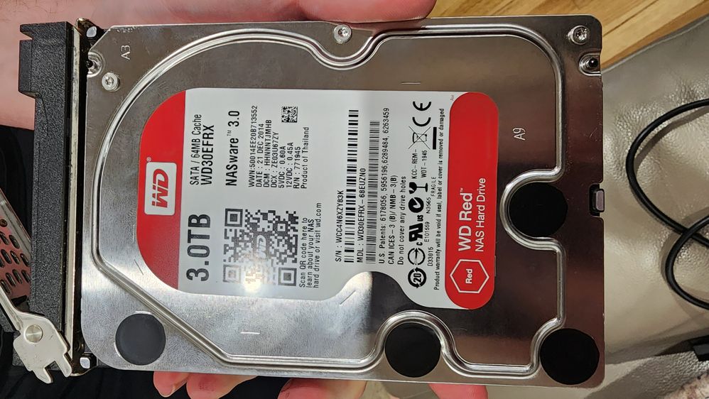

      Top one i have 4 of the top photo, 1 of the second and 1 WD.
      WDis running up. 2 of the Seagate's are running up...
      the refurbished one and 2 of the top ones are not.
      The kids say one is certainly gone as it clicks then shuts down. Another is clicking but not shutting down, but not running up. Third is just spinning but not running up.
      The other two they aren't 100 % sure as they say there may be other reasons.
       It's odd as I bought it with all WD NAS drives.... but they aren't there now.
      Now I'm lost as to what to do, as I'm pretty sure if its more than 2 drives gone my data is lost?  I cant recall what raid I ran though, if it was mirror or stripped. We cant read data though.
