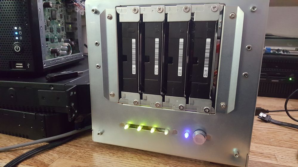

- SandsharkApr 24, 2020Sensei
Wow. Off-topic, but is that 600 yours? I've been in this game since the original Infrant NV w OS3.x, but the 600 is even earlier. Had massively heavy Seagate Enterprise 500GB drives in it. Seemed a huge amount of space at the time.
