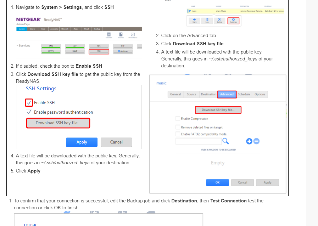

I am following the Backup job proc. here:
It seems to imply that only the folders that appear at the top of the tree (and what appears below them) can be individually backed up. Is that right?
In the following screenshot it says to place the key in ~/.ssh/authorized_keys:
https://i.gyazo.com/75cecc6816db560f7263ef8334ceb746.png

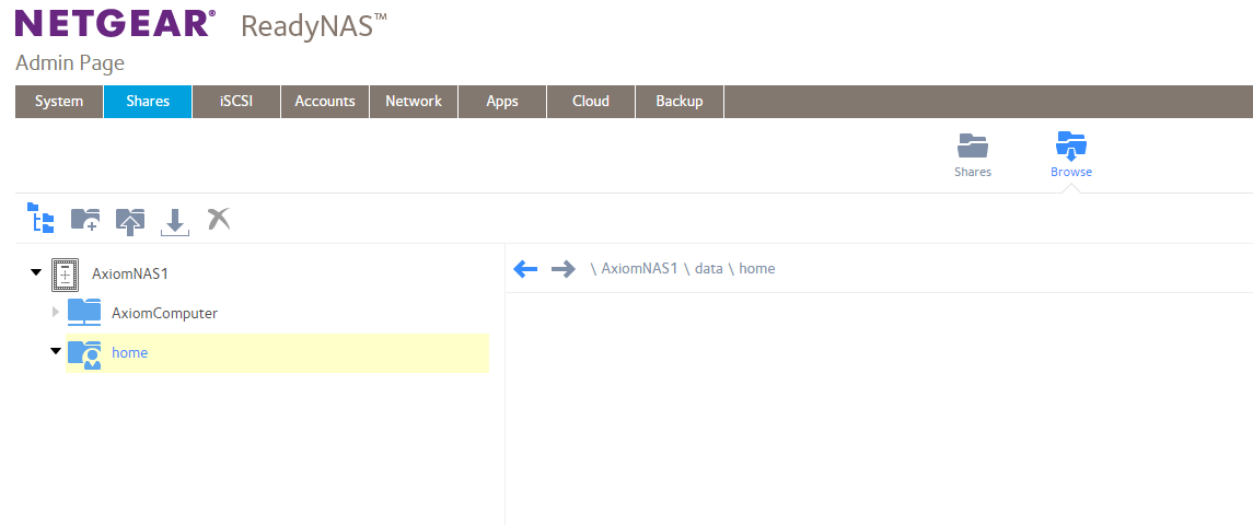

how do you get there or are those dir created?
This is what I see: https://i.gyazo.com/6cb5abca79a42c0d2cbc81f9855fb206.png
