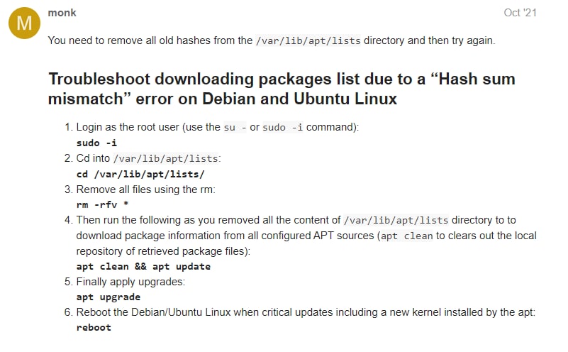

      SauvageSausage
      You may want to check on this link
      Skip on apt-upgrade and use rn_shutdown -r instead of reboot
      Please let me know if this helped.

      • Thanks Marc_V but it didn't help:
        # sudo apt-get install -y libc6-dev
        Reading package lists... Done
        Building dependency tree
        Reading state information... Done
        The following additional packages will be installed:
          libc-dev-bin linux-libc-dev
        Suggested packages:
          glibc-doc manpages-dev
        Recommended packages:
          manpages-dev
        The following NEW packages will be installed:
          libc-dev-bin libc6-dev linux-libc-dev
        0 upgraded, 3 newly installed, 0 to remove and 37 not upgraded.
        Need to get 790 kB/3,027 kB of archives.
        After this operation, 15.1 MB of additional disk space will be used.
        Get:1 https://apt.readynas.com/packages/readynasos 6.10.7/main amd64 linux-libc-dev amd64 4.4.218.1 [790 kB]
        Err:1 https://apt.readynas.com/packages/readynasos 6.10.7/main amd64 linux-libc-dev amd64 4.4.218.1
          Hash Sum mismatch
        Fetched 790 kB in 0s (863 kB/s)
        E: Failed to fetch https://apt.readynas.com/packages/readynasos/dists/6.10.7/main/pool/l/linux/linux-libc-dev_4.4.218.1_amd64.deb  Hash Sum mismatch
        E: Unable to fetch some archives, maybe run apt-get update or try with --fix-missing?
