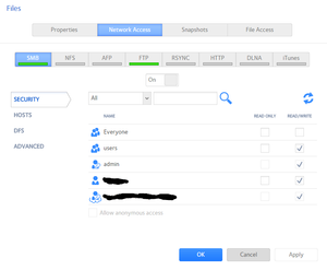

RN-102 User account cannot access shares over SMB.
I have a ReadyNAS 102 that has a share on it called "Files". The permissions of "Files" are set to allow read/write access to everyone in the user group, the admin account, my local user account (on ...

- soapbox55May 25, 2017Guide
The NAS and computers are all on "WORKGROUP".
When I run that command with the admin account (and also the cloud user account) it returns:
The command completed successfully.
I can log in through windows explorer as admin as well. I just cannot log in using my local user account that I created on the NAS. The account I use on my computer and the account on the NAS have the same username and password, so it should accept that login.
