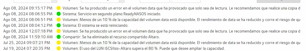

With a RN102 with only one 2 Tb disk I have some SMB Shares and one Iscsi target. Yesterday I delete an SMB Share and since then I receive a message saying “There is an error on data volume and it’s turned on read only. We recommend doing a backup” (or something like this, I translate the Spanish message). The current running firmware is 6.10.10. I have some questions:
    It looks like the error was triggered because you ran out of free space.
