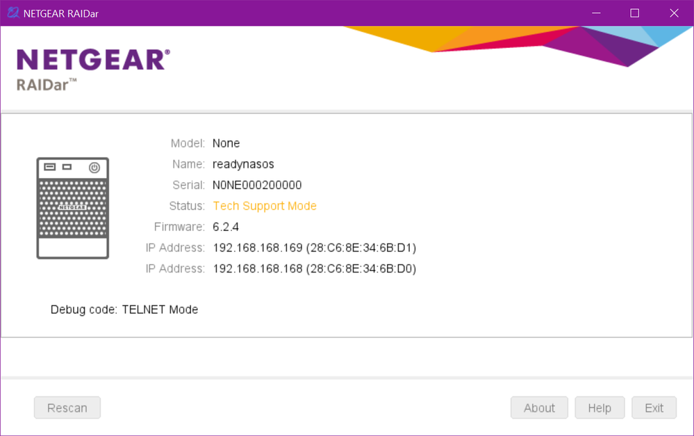

I tried updating the firmware. I started with 6.10.10 (which turned out impossible, but at that time I didn't know I was still at 6.2.4), which got the NAS stuck at IP:TELNET. That is when RAIDar finally recognised the device (and when I found out the firmare version), with 'Model: None' and 'Serial: N0NE00200000'.

      I just noticed that when booting from USB without an image on it, RAIDar detects the nas in 'Tech Support Mode', although it doesn't detect (the absence of) any disks). How would I trigger the firmware update from that?
        You'd first log into the NAS via telnet (using the back door password), and then mount the OS partition.
        From there you would copy the firmware image to /etc/.flash_update and reboot the NAS.
        If you want to try that, I'd suggest installing 6.2.4, as that seems safer than trying to go forward.
