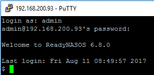

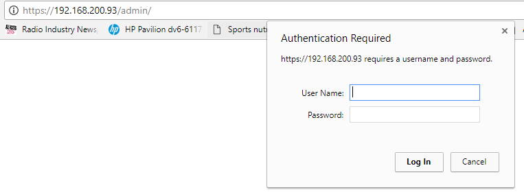

Here is the latest update on situation. I can logon to the NAS via ssh and the web admin page is responding now, however, it won't accept my credentials.
Does the web admin page use different credentials than ssh?
Thanks!
- StephenBAug 11, 2017Guru - Experienced User
With SSH you are supposed to log in as root, though it will accept admin.
Root and admin both use the same password (and there is only one admin account, so the web ui also uses that password). Note you do need to log into the web ui as admin.

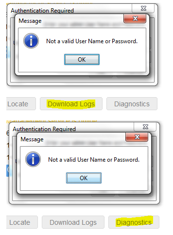

- morelorAug 11, 2017Aspirant
That's what I figured. Any ideas why the web ui is rejecting the credentials?
I am also still unable to access diagnostics or logs from RAIDar. I'm assuming that RAIDar is basically just an extension of the web ui.
SSH accepts the credentials.
I've tried the web ui/RAIDar from 3 different computers. Also, for what it's worth, I cannot manage the NAS via the ReadyCloud account either.
