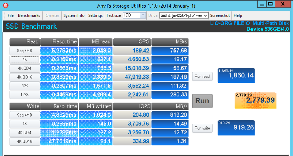

Here's where I'm at right now...which is acceptable (but this is under 0 load with no VMs running, and NOT in CSV).
10 drive X-RAID RAID6 (2 global spares). Just factory reset and rebuilt on 6.8.1. Dual 10Gb Intel X520 NICs (not the crap they come with), jumbo frames
This is WAY better than I was getting yesterday (total score was 1,045)
I used all defaults in the software.

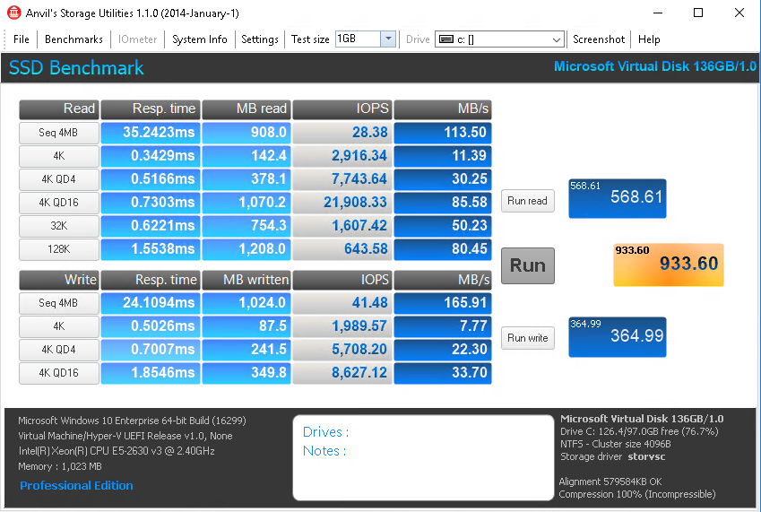

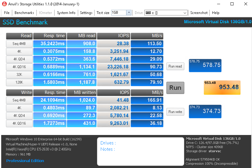

For the heck of it, I converted the test VM from a dynamic to a fixed size VHDX and re-ran the numbers
The slight reduction in performance is likely just because we're into business hours now and the system is getting busier. So it isn't inefficiencies in dynamic disks.
