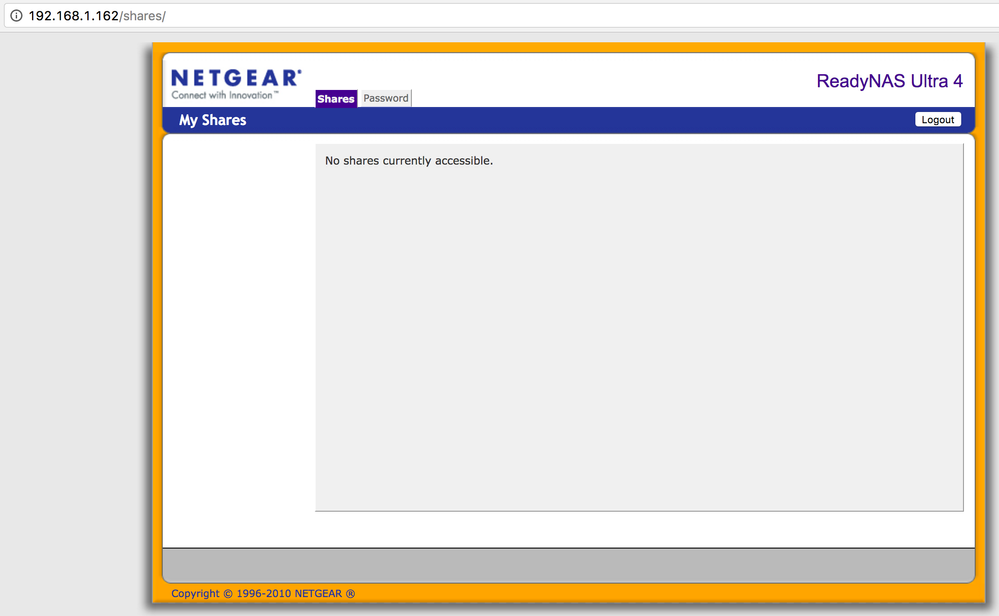

Hello,
I purchased an ReadyNAS back in 2011 and was using it up until 2013 when I divorced. I just plugged it back in and tried to access via my macbook pro and could not. On the front of the ReadyNAS, it shows the IP address 192.168.1.162
I cannot find it on RAIDar either with my old version 4.3.8 nor with the new version I just installed 6.3-T1
I can see it listed as a connected device on my router, and I can connect to it directly via the IP address, but it says that no shares are currently accessible (see picture).
I assume that the firmware is old or corrupt or that I have some kind old add-on that is no longer supported, but am hesitant to perform an OS reinstall using the boot menu as explained in the link below without some guidance...
The ReadyNAS contains all the baby pics from my two boys, and I would really appreciate any guidance from the community.
Thanks!

That screen only means that you have no shares that are set up to use http as the file sharing protocol.

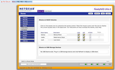

What happens if you enter https://192.168.1.162/admin ? You should get a username/password prompt. Do you know the admin password of the NAS?
Also, did you try using finder to connect to the NAS using it's IP address?
- maudigierAspirant
Wow - that did it! I was able to access the admin tool (pic below) as well as connect to my desired share via finder. I confirm that I was able to access my pictures. Thanks so much!
Would you recommend a firmware update or anything else to get it up to snuff before I start using it again?
