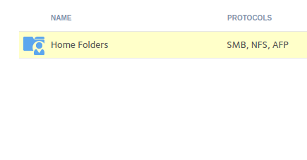

Shares lost from admin page
My ReadyNAS 212 has lost all shares and I only see: I have looked at other articles mentioning the same, and I have checked I am not running out of space. And also, when I ssh to the system, ...
