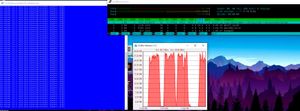

smbd / btrfs-Transaction high load on cpu - Bug while Backup Job WIndows 10
Hey guys, while WIndows wbadmin Backup i get the following problems, which leads to
- NO ACCESS to my File System while btrfs-transaction is on high load (Browser stuck / Explorer Stuck)

process which takes 100% load "brtfs-transacti "
why a transaction on the file system stopps the whole samba process by sucking away the power ?

* balancing finished after 3 hours - still the same Problem
* Nas-Reboot - still the same Problem
* CPU/Memory affects reading from disk to ethernet via Samba (kworker/u2:0 10%, kworker/u2:3 10%, kworker/u2:4 10%)
Steps which finally did something:
* switched now "strict-sync" in everyfolder off (THANKS FOR THAT TIP)
Big Files ( > 1GB) read speed ~ 40MB/s
Smaller Files (1-700MB) read speeds ~ 62MB/s
Image Writing speeds ~ 32 MB/s (now with small gaps , but no timeouts anymore)
