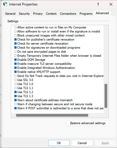

        Try running inetcpl.cpl  Go to the advanced tab, and scroll down to the bottom of the pane.  This is what I see on my Win 11 laptop:
