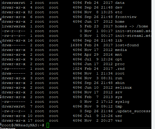

I was wondering what can I delete under the /var/ folder? its taking up around 700MB of space and my admin page is not loading anymore.
StephenB
Nov 03, 2018Guru - Experienced User
Your folder numbers don't add up to your total, so you are missing something.
Have you tried using du /mnt -ah -d 1 ?
Also, have you used ls /mnt -al, to see if there are hidden files in the root folder that are taking up space? There are some hidden files, but they should all be small

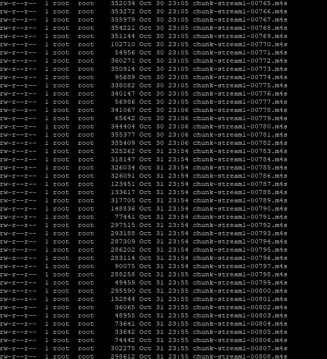

Here are the resulkts of the first command.
I have a ton of these weird chunk-stream one files
- StephenBNov 09, 2018Guru - Experienced User
Those are from plex (transcoding). These are in the root volume somewhere? Not in /apps?
If so, it should be safe to delete them. But they might come back, so you'd need to keep an eye out.
So if they are in their own folder(s), I suggest that you move them to a share on the NAS, and replace the folder(s) with "soft links" that points to the folders on the share. This would keep them out of the root partition, and let you see how much space they take up.
After you delete the current folder, the command for the soft link would be
# ln -s /data/<whatever> <current folder name>
