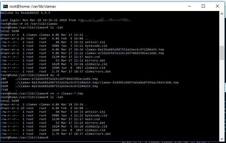

    Be careful on the typing of the commands below. Be sure to use the correct slash direction, etc.
    After you are logged in, you enter
    cd /var/lib/clamav
    ls -lsh
    You should now see a folder listing, with some folders that look like clamav-<very long string>.tmp
    If you don't see these tmp folders, then post back and tell us what you do see.
    If you do see these tmp folders, then you remove them by entering
    rm -r clamav-*.tmp
    ls -lsh
    You should now see a second folder listing, and those tmp folders should be gone.
    asimb has posted a screen shot illustrating these commands:  https://community.netgear.com/t5/Using-your-ReadyNAS-in-Business/System-volume-root-s-usage-is-xx-This-condition-should-not-occur/m-p/1722860#M178464
    I'm taking the liberty of re-posting that screen shot here.
    I recommend leaving the AntiVirus service off - at least for now.

    Be careful here, as there are support implications in trying to fix this yourself.  Typing the wrong thing can do damage, and require you to do a factory default to recover.  So I recommend backing up the NAS first.  https://kb.netgear.com/30068/ReadyNAS-OS-6-SSH-access-support-and-configuration-guides
    You first disable the AntiVirus service - which it sounds like you have already done.
    The second step is to enable SSH in the NAS web ui in system->settings.  If your password is still set to password, you also need to change it to something else.
    Now you need a program to connect to the NAS using SSH.  Windows 10 has a program built in (called ssh).  So do Macs (terminal).  For other windows versions you need to install putty from https://www.chiark.greenend.org.uk/~sgtatham/putty/latest.html  (and you can also use putty on Windows 10 if you like).
    Then you use that program to connect to the NAS:
    1. ssh root@nas-ip-address on Windows 10 (entered on the Windows 10 search bar)
    2. launch terminal, enter ssh root@nas-ip-address on the mac
    3. launch putty, make sure ssh is selected as the connection type. Enter the nas-ip-address and click open.  Enter root as the username.
    Use the real NAS IP address of course. It's important to log in as root.  Don't log in as admin.   When you see the password prompt, enter the NAS admin password (root and admin use the same password).
    If you have trouble launching one of these programs, then you can post back (or just google for more info).
    cd /var/lib/clamav
    ls -lsh
    rm -r clamav-*.tmp
    ls -lsh

      • StephenB's avatar
        StephenB
        Here's what I see on my RN202:
        root@RN202:/mnt# du -d1 -h
        6.0M    ./bin
        4.0K    ./proc
        4.0K    ./boot
        11M     ./sbin
        24K     ./tmp
        16K     ./lost+found
        4.0K    ./run
        31M     ./frontview
        4.0K    ./sys
        12K     ./dev
        8.9M    ./etc
        4.0K    ./media
        3.9M    ./opt
        4.0K    ./apps
        4.0K    ./mnt
        4.0K    ./data
        4.0K    ./home
        217M    ./usr
        29M     ./lib
        325M    ./var
        4.0K    ./Data-2
        40K     ./root
        4.0K    ./srv
        Biggest differences appear to be in /opt and /var/log
        root@RN202:/mnt/opt# du -d1 -h
        2.2M    ./readycloud
        740K    ./p2p
        204K    ./xcloud
        24K     ./remote
        748K    ./replication
        3.9M
        root@RN202:/mnt/var/log# du -d1 -h
        53M     ./journal
        480K    ./readynasd
        3.3M    ./frontview
        4.0K    ./fsck
        260K    ./samba
        4.0K    ./apache2
        24K     ./apt
        57M     .

    • StephenB's avatar
      StephenB
      Bernard46 wrote:
      The log for today shows the following messages:-
      The log messages says the ROOT directory is 84% full (and climbing by 1% every 2 or 3 days) - the df command seems to say a directory (md0 ?) is 89% full, but I'm not sure these are talking about the same thing - probably not.
      Actually it is the same.  md0 is the RAID array (virtual disk) for the OS partition (e.g., the root).
      Bernard46 wrote:
      Please can someone shed some light on what is happening with this system and what I should do to resolve what looks like a serious problem looming?
      It'd be prudent to back up the data on the NAS right away.  A full root can result in a bricked NAS or damaged configuration files.
      Once that is done, you have the option to do a factory default (which reformat the disks and does a clean install).  Then reconfigure the NAS and restore the files from backup.  That would completely resolve the issue.
      The other option is to try to find the file(s) that are causing the problem, and then delete them.  That can take some time, and of course you do have to be cautious when deleting things.
      If you want to look more closely, the best starting point is to remount the root as /mnt.  The reason is that there are other mount points on the root that appear to be part of the root partition, but really are folders on the data volume.  Exploring /mnt eliminates that problem.  This command will do that:
      mount --bind / /mnt
      Then enter
      du -csh /mnt/*
      That will give you the data stored in each in each subfolder, and give you a clue where the space is going.
      You should see space usage similar to this:
      root@RN102:~# mount --bind / /mnt
      root@RN102:~# du -csh /mnt/*
      4.0K    /mnt/apps
      5.7M    /mnt/bin
      4.0K    /mnt/boot
      4.0K    /mnt/data
      12K     /mnt/dev
      9.4M    /mnt/etc
      31M     /mnt/frontview
      0       /mnt/ftp_ban.tbl
      4.0K    /mnt/home
      0       /mnt/homes
      30M     /mnt/lib
      16K     /mnt/lost+found
      56K     /mnt/media
      4.0K    /mnt/mnt
      16M     /mnt/opt
      4.0K    /mnt/proc
      36K     /mnt/root
      4.0K    /mnt/run
      11M     /mnt/sbin
      12K     /mnt/share_lun_ui_fix.sh
      4.0K    /mnt/srv
      4.0K    /mnt/sys
      24K     /mnt/tmp
      269M    /mnt/usr
      446M    /mnt/var
      815M    total
      root@RN102:~#
      Likely you'll see a folder on your NAS that has a lot more space than these.  You can then explore that further by adding the folder to the command.  For instance, this will look deeper into var:
      root@RN102:~# du -csh /mnt/var/*
      102M    /mnt/var/backups
      85M     /mnt/var/cache
      4.0K    /mnt/var/cores
      4.0K    /mnt/var/ftp
      260M    /mnt/var/lib
      4.0K    /mnt/var/local
      0       /mnt/var/lock
      60M     /mnt/var/log
      4.0K    /mnt/var/mail
      16K     /mnt/var/netatalk
      4.0K    /mnt/var/opt
      13M     /mnt/var/readynasd
      0       /mnt/var/run
      16K     /mnt/var/spool
      4.0K    /mnt/var/tmp
      8.0K    /mnt/var/www
      518M    total
      root@RN102:~#​
      Once you find the problem folder(s), you can list them with ls, and then post the details here. Then we can give you some further advice on what to do.
