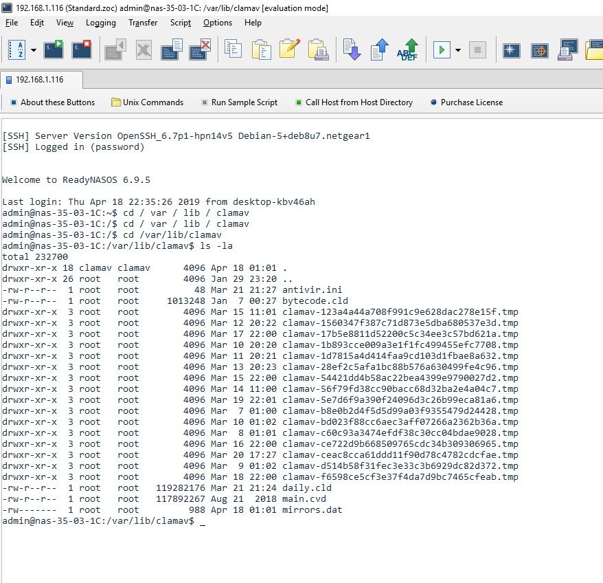

- dasgwegApr 18, 2019Aspirant
What's next? How to clean ??- StephenBApr 18, 2019Guru - Experienced User
I responded on your other thread. You need to log in as root. Then you will be able to delete the tmp files.

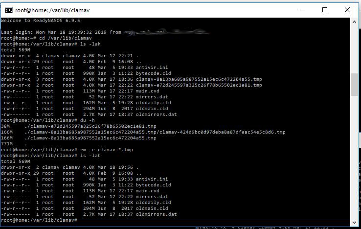

Hi,
attached you can find a screenshot showing, what I did to "repair" my NAS

- Bell98Mar 21, 2019Guide
Many thanks asimb for the solution and image. My ReadyNas antivirus also stopped updating on 5th March and the clamav had 32 .tmp files at 166M each. I've now turned off the antivirus.
