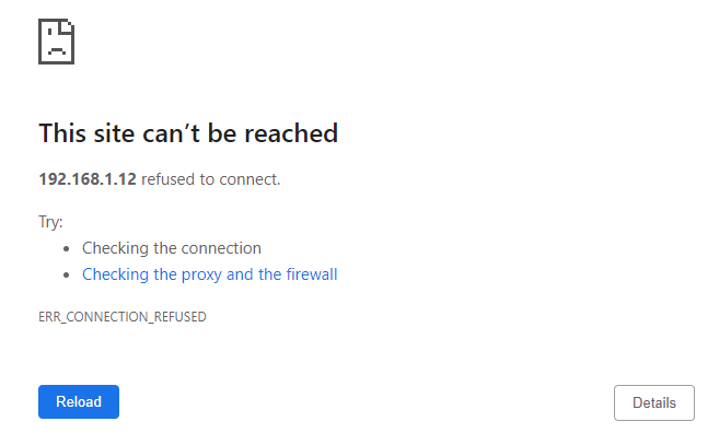

Tried using RAIDar and lo and behold it found my NAS, could locate it and tell me if it's healthy (it is). BUT when I try:
- Clicking on Browse, it just sends me to my Documents page
- Clicking on Admin Page, I get this message:
So now I turn to you guys to see if anyone has a sollution to my problem.
