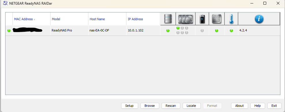

    • StarrTech's avatar
      StarrTech
      the web GUI shows firmware version
      and also RAIDar show this

  • Additional note:
    I used Firefox and set it to tls and also tried a older version of opera, i also noticed that there is no addon in in the addon tab.
