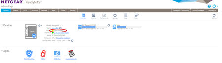

Hi, I have an issue with my UPS. My readyNAS shows me a warning about the UPS but it's not clear for me, the info is weak. An another strange thing the ups error event is not recorded in my log :-...

Here the status from ReadyNAS UPS log:
***** UPS *****
battery.charge: 100
battery.charge.low: 20
battery.runtime: 3000
battery.type: PbAc
device.mfr: EATON
device.model: Ellipse ECO 1600
device.serial: 000000000
device.type: ups
driver.name: usbhid-ups
driver.parameter.pollfreq: 30
driver.parameter.pollinterval: 2
driver.parameter.port: auto
driver.parameter.productid: ffff
driver.parameter.serial: 000000000
driver.parameter.synchronous: no
driver.parameter.vendorid: 0463
driver.version: 2.7.3
driver.version.data MGE HID 1.38
driver.version.internal: 0.41
input.transfer.high: 264
input.transfer.low: 184
outlet.1.desc: PowerShare Outlet 1
outlet.1.id: 2
outlet.1.status: on
outlet.1.switchable: no
outlet.2.desc: PowerShare Outlet 2
outlet.2.id: 3
outlet.2.status: on
outlet.2.switchable: no
outlet.desc: Main Outlet
outlet.id: 1
outlet.power: 25
outlet.switchable: no
output.frequency.nominal: 50
output.voltage: 230.0
output.voltage.nominal: 230
ups.beeper.status: enabled
ups.delay.shutdown: 20
ups.delay.start: 30
ups.firmware: 02
ups.load: 9
ups.mfr: EATON
ups.model: Ellipse ECO 1600
ups.power.nominal: 1600
ups.productid: ffff
ups.serial: 000000000
ups.status: OL
ups.timer.shutdown: 0
ups.timer.start: 0
ups.vendorid: 0463
