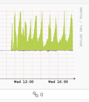

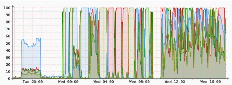

Looking at the data I get from SNMP I discovered the NAS is completely overloaded on the CPU side. The attached graph is from the NAS receiving a single VM replica and doing nothing else.

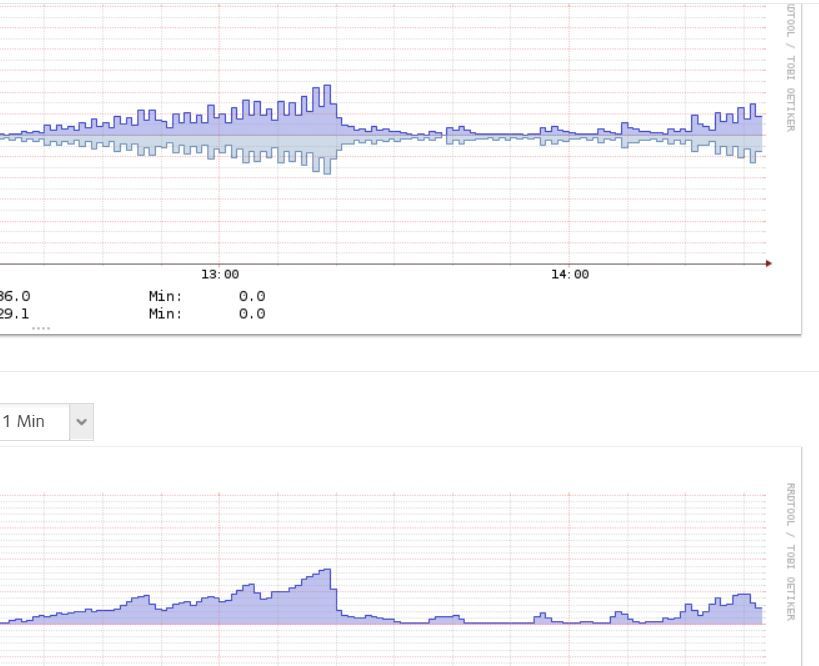

The second graph is the network (peaks are at 300 mbit).

        Today I'm trying to run a backup and I get horrible performance and not constant. In the graph below up is IOPS and down Network.
        It goes up, then drops and then slowly gets better, but nothing acceptable.
