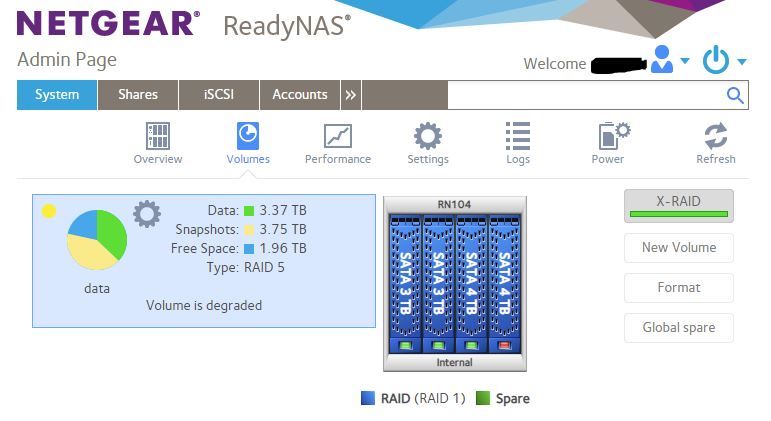

    • Warhead666's avatar
      Warhead666
      Thank you for your quick and clear response (and the hopefully good news).
      I've attached a screenshot - I note it does say "Raid 5" as well.
      Does that look as it should? If so, I'll get straight to ordering that new drive.
      • Sandshark's avatar
        Sandshark
        Sensei - Experienced User
        Yep, that's the normal display for a single failed drive but data still intact due to RAID.
