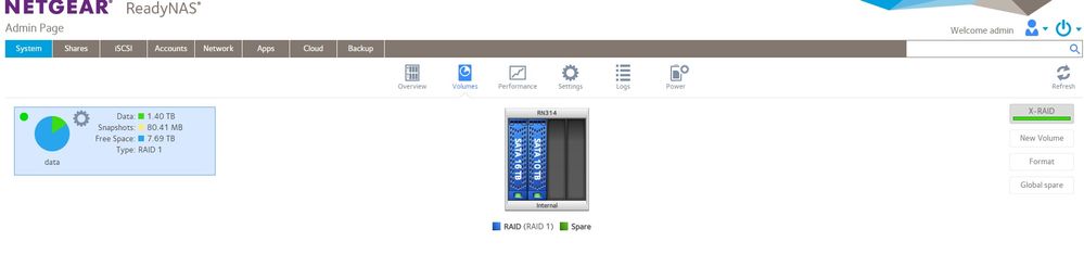

- claynzJan 31, 2021Guide
I removed the drive from the NAS and performed a factory reset on the single drive left in the NAS.
I un-partitioned the other drive in another PC and added (16TB) back to the NAS and it took awhile to resync, now I can not do anyhting with it, I would like to use it as a seprate drive.
The only thing I can do is toggle the X-RAID
- StephenBFeb 01, 2021Guru - Experienced User
Allowing the second disk to resync was a waste of time. What you should have done is toggled X-RAID off before you added the disk back, and then created a second volume.
What you do now is:
- toggle XRAID off
- destroy the current volume (option is on the volume settings wheel).
- create two new ones.
