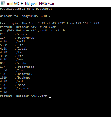

  • hard2name wrote:
    It just looks like all of mine must have more junk than yours (cores/lib/ftp) but the big problem looks like "log."  Any thoughts on what I need to do here?
    Yes, it's definitely /var/log.
    Try going deeper, that would help sort this out:
    root@NAS:/var/log# du -h /var/log
    0       /var/log/news
    112K    /var/log/apt
    0       /var/log/fsck
    436K    /var/log/frontview/backup
    3.1M    /var/log/frontview
    0       /var/log/samba/cores/nmbd
    0       /var/log/samba/cores/smbd
    752K    /var/log/samba
    3.2M    /var/log/apache2
    2.3M    /var/log/readynasd
    39M     /var/log/journal/6c58f1a31323453ea933c21fd1d53cbe
    0       /var/log/clamav
    0       /var/log/audit
    50M     /var/log
     Anything in /var/log/clamav can be safely deleted, the RN102 no longer has the AV service.

      • hard2name's avatar
        hard2name
        Here is what mine shows:
        It just looks like all of mine must have more junk than yours (cores/lib/ftp) but the big problem looks like "log."  Any thoughts on what I need to do here?  I very much appreciate your assistance Stephen B.  You are on a ton of these posts and it's great that you help so many people with this stuff, it's extremely generous of you.  Thanks again.
