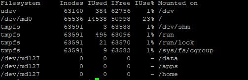

Hi I seem to be having the same issue. I'm running firmware 6.9.5. I've tried ssh to the device and using the command df -i i get the following in putty:
As far as I can tell from this I don't seem to have a problem as the highest usage is 23%. Can anyone provide any better checks for diagnosis? I'm not an SSH expert so step by step help welcome!

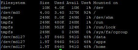

df -h gives
so clearly the /dev/md0 bit is the problem.

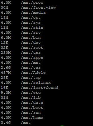

I've then done:
mount --bind / /mnt du -d1 -h /mnt umount /mnt
This gives:
So the problem seems to be either the 230M /mnt/usr, or the 487 /mnt/Adele
- StephenBMar 17, 2019Guru - Experienced User
Adele shouldn't be there at all - do you have any idea what it is? It's certainly part of the puzzle (500 MB). If you have another copy of it's contents you should delete it. If not, you can copy it to an existing share on the data volume and then delete the copy in the root. Later on you can put it where you really want it.
But the big problem is /var (2.6 GB) That's about 2 GB more than it should be. So try the mount again and descent into /var. See if you can find where the bulk space is going. When you find the folder, look at the actual file sizes (ls -al), since it might be just one or two files.
