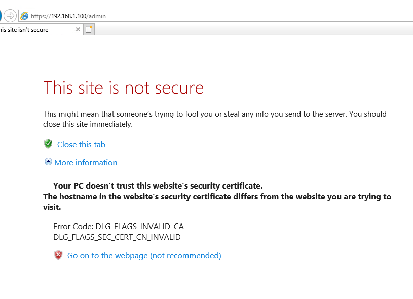

  • saxguy1 wrote:
    IE settings and resulting page (via Apache https://) are as
    This is a usual cert warning, and not the SSL  protocol mismatch.  You can access the NAS by clicking on "Go on to the webpage (not recommended)".
    Note that this particular warning is strongly worded, because you really shouldn't go on unless you know you are connecting to the device you intend to reach.  In this case, you do know that.
    Chrome removed all support for TLS 1.0, so there isn't much point in looking there.  Edge will let you connect if you use "IE mode"  https://docs.microsoft.com/en-us/deployedge/edge-ie-mode
    But I expect that IE/Edge support for TLS 1.0 is temporary - I wouldn't count on it being available for the long term.
