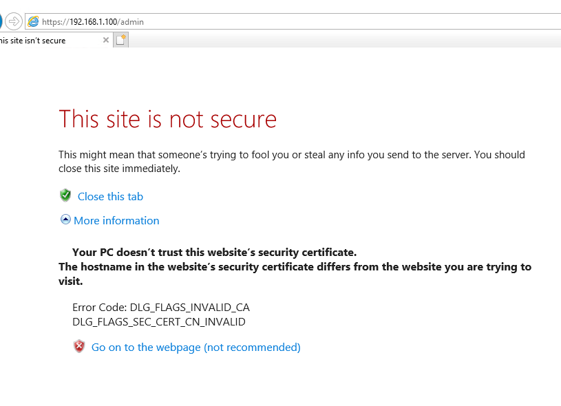

saxguy1 wrote:
IE settings and resulting page (via Apache https://) are as
This is a usual cert warning, and not the SSL protocol mismatch. You can access the NAS by clicking on "Go on to the webpage (not recommended)".
Note that this particular warning is strongly worded, because you really shouldn't go on unless you know you are connecting to the device you intend to reach. In this case, you do know that.
Chrome removed all support for TLS 1.0, so there isn't much point in looking there. Edge will let you connect if you use "IE mode" https://docs.microsoft.com/en-us/deployedge/edge-ie-mode
But I expect that IE/Edge support for TLS 1.0 is temporary - I wouldn't count on it being available for the long term.

You should have gotten the cert warning when browsing before. The NAS uses self-signed certificates, and those cannot be verified. Just click through the "go on to the webpage" link.
It looks like you did see that, and then got to login prompt. What happens when you enter "admin", and the NAS admin password?

The SSL version mismatch error suggests otherwise. Did you attempt to explicitly go to http://192.168.1.100/admin in your usual browser? (Explicitly choosing http, not https).

saxguy1 wrote:
IE insists on making it SSL and so I get the error.
Actually it's the NAS apache server that is redirecting http to https for the admin page. The patch in the workaround thread eliminates that workaround, and then http will work. Though that particular patch has only been tested with v1 NAS (4.1.x firmware). I tested it with Chrome and Edge - I don't recall if I also tried IE.
IE actually still supports TLS 1.0 (likely not for much longer). You'll still get a certificate warning, but not the SSL protocol mismatch error.

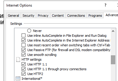

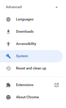

- saxguy1Apr 05, 2022Guide
IE settings and resulting page (via Apache https://) are as attached
Chrome settings don't show in "advanced' where one is supposed to be able to enable a legacy TLS setting
Edge also using edge://flags/ doesn't reveal settings to enable a legacy TLS setting
Not sure what can be done at this point
