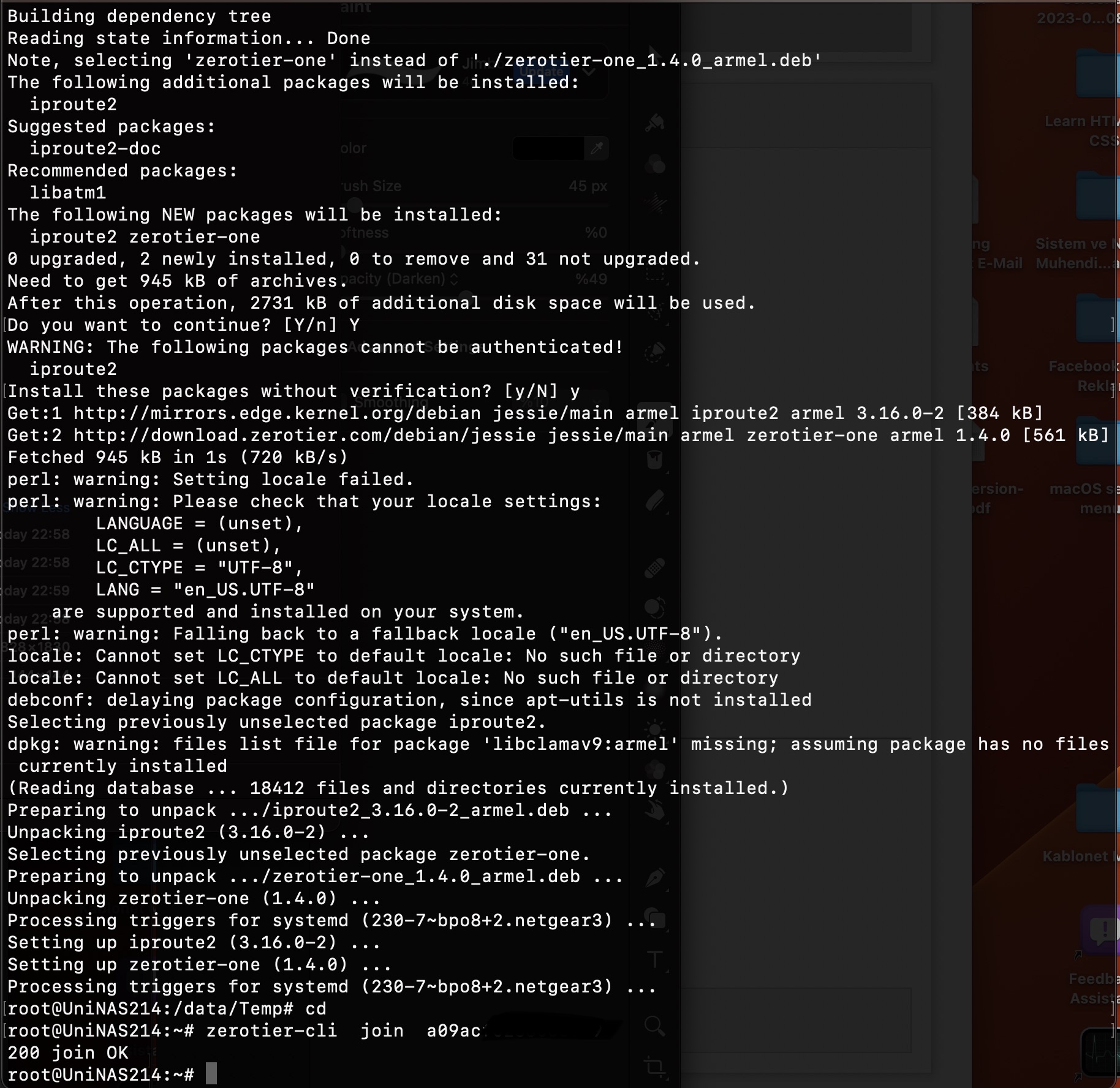

I also try to install ZT to ReadyNAS via Web UI and SSH but installing failed on RN214 Arm V7, firmware: 6.10.8

Well, It seems curl script no longer works in Debian Jessie as you mentioned.
Web UI always fails to install both 1.1.14-nt3 and 1.4.0
Local/manual install V1.4.0 (as you did with V1.6.6) worked for my armel RN214 OS6.10.8 (with kernel plus installed).

Additionallly I've been able to install ZT 1.1.14-nt3.deb locally via SSH, now it's working on RN214 (v6.10.8) with GUI 👍
(Btw. Tested it from scratch after factory reset).
