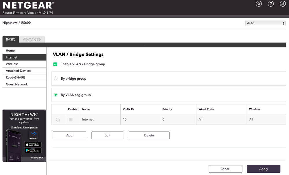

    I show my RS600 having VLAN support options under the Internet section of the UI which would be part of the WAN side:
    You would need to check with the ISP to see if this section can be configured for an ISP use.
  • FURRYe38 That table you show with the name internet is the name of the tag group. Not necessarily the internet port. When you click on edit, there should only be 7 options for ports 3 wifi options and 4 for ports 1-4. None of them are available for the WAN/Internet port. I know its possible with 3rd party configs but I am not trying to void my warranty. What I do know is that the hardware can do it. The firmware just needs to be updated to allow this
  • FURRYe38's avatar
    Something to contact NG support about to check with them then.
