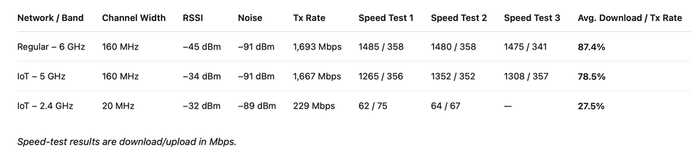

The results are in a table in the attached image.
The wireless connection information shows a very substantial difference between the three connections. On the regular 6 GHz network, the M4 connected on channel 69 at 160 MHz with a Tx rate of 1,693 Mbps. On the 5 GHz IoT network, it connected on channel 48 at 160 MHz with a Tx rate of 1,667 Mbps. Those connections produced average Internet download throughput of approximately 1,480 Mbps and 1,308 Mbps respectively.
On the 2.4 GHz IoT network, the Mac connected on channel 11 using a 20 MHz channel, with a reported Tx rate of 229 Mbps. Actual Internet throughput was consistently much lower, at 62–64 Mbps download and 67–75 Mbps upload.
The 2.4 GHz test was performed under what should be close to ideal RF conditions. RSSI was −32 dBm and noise was −89 dBm, for approximately 57 dB of signal-to-noise margin. The M4 was also only about eight feet from the RBE970. Therefore, weak signal strength or excessive distance from the satellite should not explain the approximately 63 Mbps download result.
The comparison should also largely eliminate my Internet connection, Ethernet backhaul or general RBE970 throughput as explanations. The same Mac in the same location was immediately capable of approximately 1.3 Gbps over the 5 GHz IoT network and approximately 1.48 Gbps over the regular 6 GHz network. The large throughput reduction appears specifically when the client is connected to the 2.4 GHz IoT network.

However, I think there is another aspect of these results worth examining. The actual download throughput as a percentage of the reported Tx rate differs considerably between the bands. The 6 GHz connection delivered approximately 87% of its reported Tx rate, and the 5 GHz connection approximately 78%. The 2.4 GHz connection delivered only approximately 28% of its 229 Mbps reported Tx rate.
I realize that these percentages cannot be directly compared as though PHY-to-application throughput efficiency should be identical across different bands and channel widths. A 20 MHz 2.4 GHz connection has substantially different airtime and overhead characteristics from a 160 MHz 5 or 6 GHz connection. Nevertheless, approximately 28% seems low enough to raise the question of whether the observed 62–64 Mbps throughput is actually what Netgear expects from this connection.
