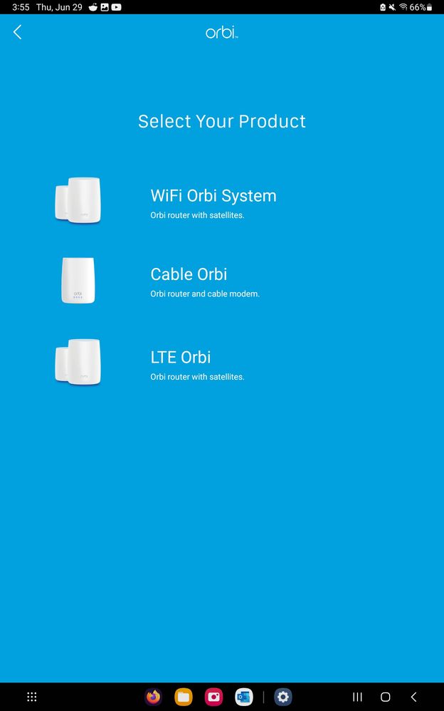

  5. Select Your Product. Press Wi-Fi Orbi System for any RBR or RBRE series models:

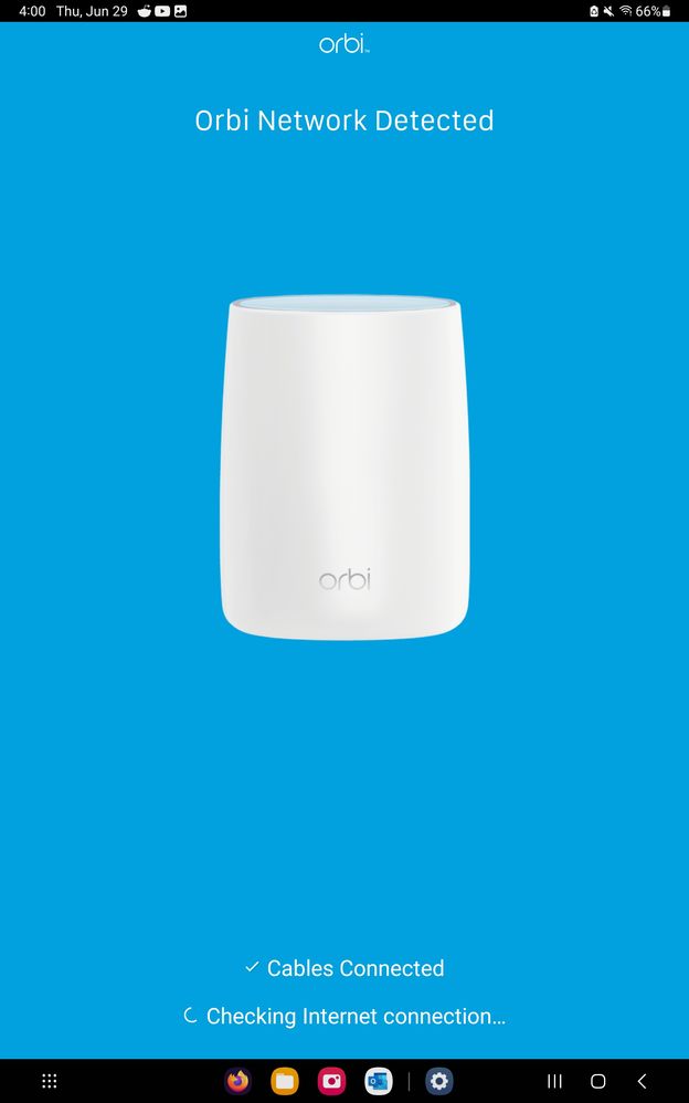

  8. On the Router Detected page, the app will display it's checking the Cables and Internet connection and service here:

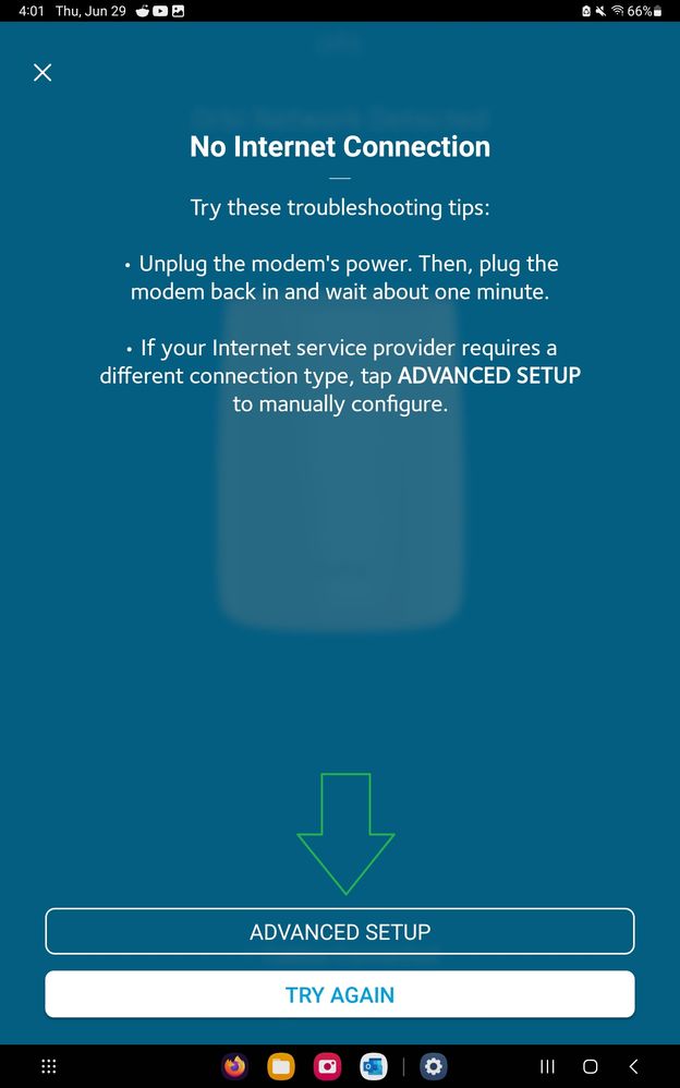

  9. The Checking Internet will fail and report a problem. If there is a Try Again button seen displayed, select Try Again button. The check will fail and then present a Advanced Setup button. Select the Advanced Setup button:

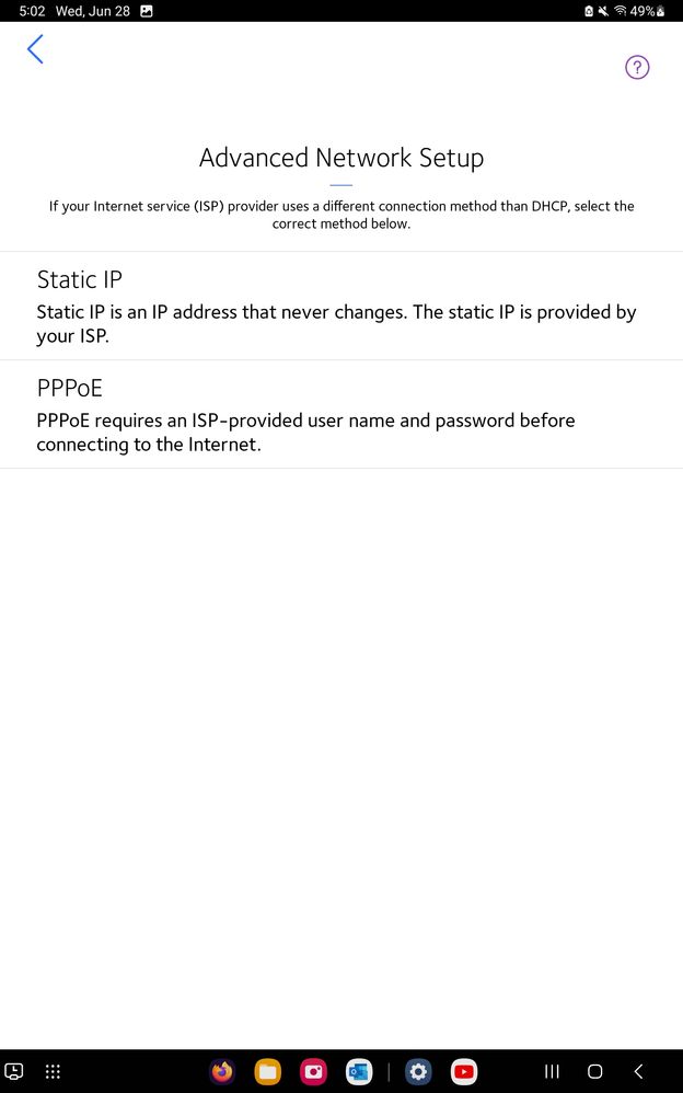

  10. This will display Advanced Network Setup with two configuration options, Static IP and PPPoE:

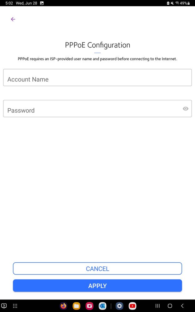

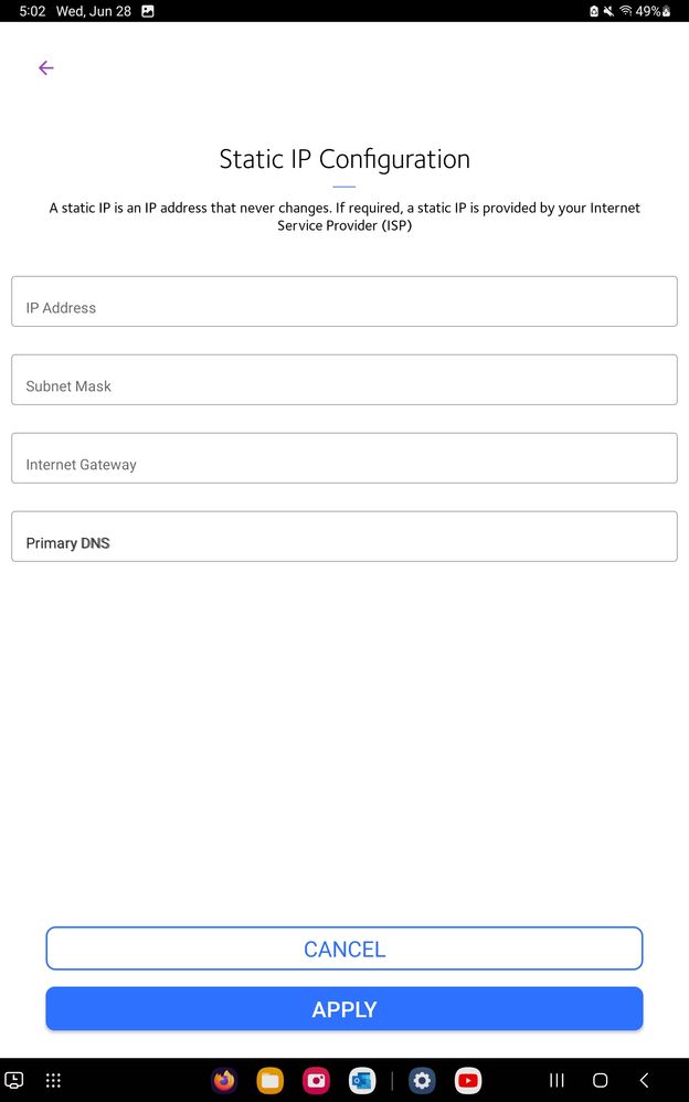

  11. Select from either of these two options to configure the WAN configuration given by the ISP here:
  12. After ISP WAN Configuration has been entered correctly, Select the Apply button to have the Orbi app save and apply the new WAN configuration changes to the router.
