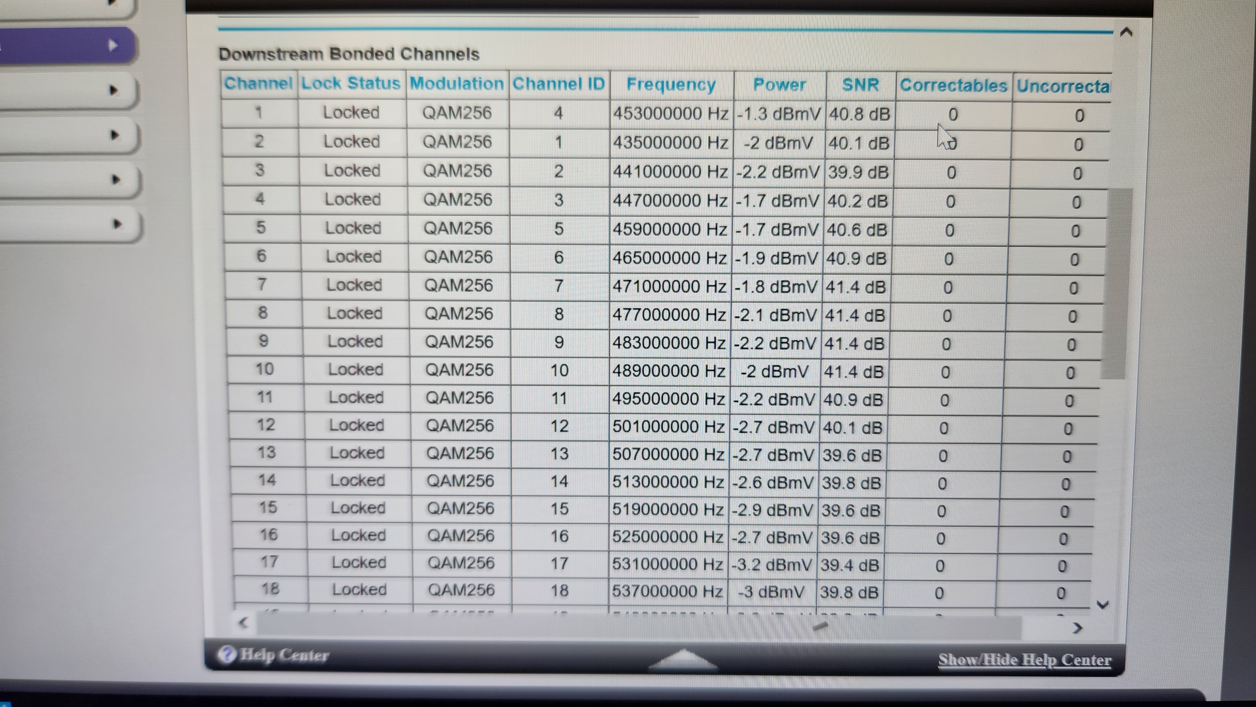

Please post a copy and paste of the modems connection status and event log page.
https://kb.netgear.com/30007/How-do-I-obtain-the-cable-connection-information-from-a-NETGEAR-cable-m...
https://kb.netgear.com/30008/How-do-I-view-or-clear-the-event-logs-on-my-NETGEAR-cable-modem-or-mode...
Does this effect both wired and wireless devices?

Re: Nighthawk C7000v2 losing connection frequently
Power looks ok. A bit low but with in specs.
Correctables and Un-Correctables are all at zero which is good.
Lets take a look at the Event logs page please.

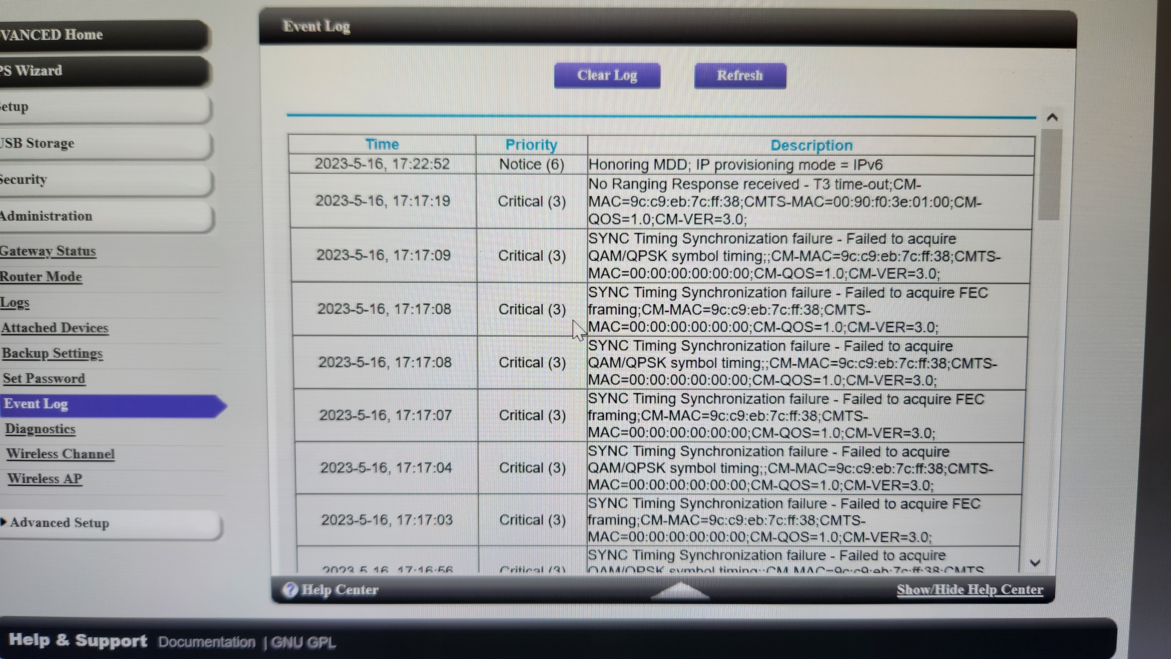

You have lots of Criticals in the logs. The ISP needs to look and review Criticals, Errors and Warnings seen in the logs. This indicates a signal problem from the ISP.
Have the ISP check the signal and line quality UP to the modem. Be sure the ISP provisions the modem correctly.
Be sure there are no coax cable line splitters in the between the modem and ISP service box.
Be sure your using good quality RG6 coax cable up to the modem.
Start with removing any amplifiers, signal attenuators, or splitters from the coax.
From there check the line for kinks, damage, moisture in the line.
Check the connectors for improperly made ends, foil touching the copper coax line, loose connections, bad/old/cheap connectors, or corroded connections. Replace them if you do.
Thank you! I have an tech coming tomorrow, I will show him your notes while he is here.
