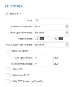

I'm having some trouble with internal-only FTP. Filezilla authenticates, but I'm unable to browse to the folder. I get the following (minus the hashtags). Status: Resolving address of ###.###.## Status: Connecting to ###.###.#.##:21... Status: Connection established, waiting for welcome message... Status: Logged in Status: Retrieving directory listing... Status: Directory listing of "/" successful Status: Retrieving directory listing of "/users;UNIX.mode=0775;UNIX.owner=33268;UNIX.ownername=administrator; IT"... Command: CWD /users;UNIX.mode=0775;UNIX.owner=33268;UNIX.ownername=administrator; IT Response: 550 /users;UNIX.mode=0775;UNIX.owner=33268;UNIX.ownername=administrator; IT: No such file or directory Error: Failed to retrieve directory listing Status: Disconnected from server The SMB configuration works fine. I only need it internally so I didn't bother with any port forwarding. The FTP client is Filezilla. The logon type is set to normal with passive transfer mode. Here's my ReadyNAS setup. I'm sure it's something simple my coffee-bereft, frazzeled brain is missing.USB Sharing type FTP (via internet) suddenly stopped working

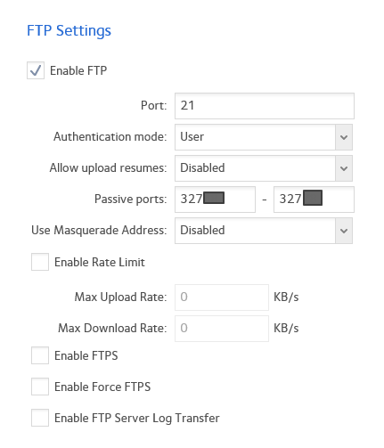

Hi, I have been sucessfully using the FTP via internet setting until one day it just stopped working. After extensive debugging I simply cannot explain it! The URL is ... ftp://myrs.mynetgear.com:1921/shares/ It just won't connect, times out on connection, nothing has changed. All the other sharing options work, including FTP from inside the network! I have tried it with the direct IP and with port 21, and every security setting there is and I still get nothing. Please help as the only option I have left is a warranty claim which seems silly given it's a software problem!Solved3.3KViews0likes7CommentsHow to disable the firewall?

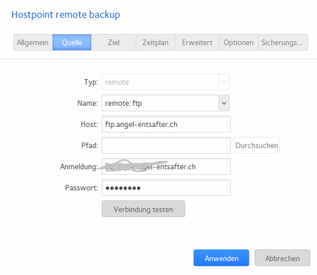

Using OS 6.5 I try to connect to a remote webserver via Backup remote FTP. Same configuration works with Filezilla and TLS. The Ready NAS gives an error message when I test the connection. Connection not possible! I'm not shure if OS6.5 does support TLS connections with self signed signatures? The destination is a local share with full and anonmous access for everybody. Any hints are welcome.3.9KViews0likes1CommentIs FrontView ProFTPd Custom Configuration Broken?
