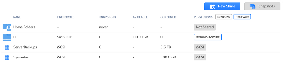

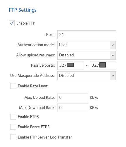

The SMB configuration works fine.  I only need it internally so I didn't bother with any port forwarding.  The FTP client is Filezilla.  The logon type is set to normal with passive transfer mode.
Here's my ReadyNAS setup.

    Is users a share on the NAS?  Did you navigate there by clicking on the foldername in the root share?
    If so, is the share set to give your user credentials access?  Check the FTP tab in Network Access (share settings), and also the File Access tab.  Perhaps enable "everyone" access intially, just for testing.

      Thanks for the reply.  The share and folder name is IT.  I vaguely remember users being a system folder for Unix.
      I did try setting the permissions to everyone, but got the same result.

        It is a bit odd, because your filezilla snippet clearly said /users was the directory that couldn't be listed.  The NAS OS partition doesn't have a /users folder, so it's not a system folder.
        Did you check permissions on the FTP tab under network access?  That might not align with the summary on the main shares page.
