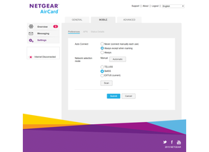

Just got one of these, specifically for the bridge mode. For use in Canada on the Bell Mobility LTE network (which I understand is supposed to be compatible. Had the SIM in a Huwei hub provided by Bell, which worked just fine. Anyway, put the SIM in the Netgear, powered on and connected directly to my PC with Ethernet. Log in and it indicates that I'm disconnected. Interestingly, it shows me an SMS, so at least those are coming through. I check the APN settings and notice it's set to pda.bell.ca. Check on the Bell site, and for turbo sticks it's supposed to be set to inet.bell.ca. So I change it. Still no connectivity. So I try manually selecting the network. When I scan, it usually shows me three networks. Bell, Rogers, and sometimes Telus but other times EXT. I have no idea what EXT is. The first time I do this, it shows Rogers as current. So I think that must be the problem. I select Bell and wait. Nothing happens. Try it again. This time after the scan it shows "EXTUS" (whatever that is) as current. Try selecting Bell again. No change. See screenshots below. Also tried turning it on and off between the change in settings. Didn't make a difference. Still disconnected. I'm pretty sure it isn't a problem with the SIM card, as it worked on the Huawei and I seem to be geting some basic connectivity (i.e. the SMS message and the ability to scan for networks). Has anyone else experienced the same issue? Not sure what else I'm supposed to do, short of returning the thing. Any suggestions would be most appreciated.SolvedLB1121 POE???
