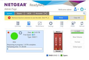

Hi, I've been using RN312 since few years on Raid 1 (4tb each drive), All good till date but today I got new hard drive to replace the existing ones which were also working perfectly. So I removed the Disk 1 and added a new 4tb drive as Disk 1. to sync it with the Disk 2. The drives were resyncing but in between I got some power issue that stopped the nas. I removed the new drive and booted the NAS with Disk 2 only but it was not showing any data and showing message "Remove inactive volumes to use the disk. Disk #1. Well I shut down the NAS and added back the new Disk 1 drive intact and after rebootitng the NAS I got the screen below, although the old drive (Disk 1) which I removed is having no issues and data is intact in my knowledge but now should I wait for the NAS to fix the drives (New Disk 1 & old Disk 2) itself or should I start planning to extract data from the old Disk 1 drive? ThanksSolved1.9KViews0likes2CommentsReadyDR Unknown Error 255 on ReadyNAS 422
