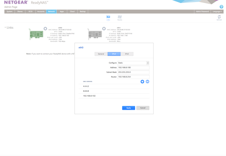

Hello all, I am suffering from an issue which a lot have in the past but cannot seem to solve it whatsoever, details below; Model: ReadyNAS 104 Firmware 6.4.1 Environment: my office with 40mbps ethernet connection. The issue is that I have a static IP connection to my NAS and DNS server settings as below but I cannot seem to enable or access ReadyCLOUD services whatsoever, screenshots to follow; I have researched extensively and have not yet managed to get it working, from my limited knowledge about NAS, I tried changing the DNS settings many times yet to no avail. I also tried rebooting yet it made no difference whatsoever. I also tried a Safari and Chrome as browsers and yet did not make any difference. I appreciate your help and thank you in advance, have a great day.Solved4KViews0likes3CommentsTips for merging photos and movies from multiple cameras and renaming to a common date format

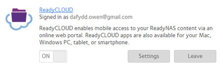

I have two ReadyNAS 104's Both recently upgraded to 6.5.0 A while back I accidentally disabled ReadyCloud on the first and then added it again - then after that had to log in to admin Pages using "admin" account rather than main user account. It works anyway so am Ok with that. Since upgrade to 6.5.0 - I need to use "admin" account on both. Now, going onto "Cloud" tab of both - the ReadyCloud option seems to be significantly different on both. Settings button also gived different options. Not a major issue as I don't use it much but thought I'd check why this is. Older machine (ReadyCloud disabled + re-added): Settings: Newer box: Settings: Thoughts ?Solved3.5KViews0likes2CommentsReadyCloud won't turn on.
