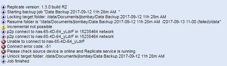

I have 2 readynas usnits runnig the latets firmware and they (after sorting out a p2p issue) backed up fine locally and now I have one unit offsite the backups are failing. Any advice please as I am tearing my hair out with these units. Log file is below. 2016-10-28 00:00:09 Job updated from server 2016-10-28 00:00:09 Replicate version: 1.3.0 build R2 2016-10-28 00:00:09 Starting backup job "FULL DAILY BACKUP" 2016-10-28 00:00:09 Locking target folder: /data/BACKUPS/FULL DAILY BACKUP 2016-10-28 00:00:13 Resume folder is "/data/BACKUPS/FULL DAILY BACKUP/2016-10-27 16-43 (failed)/data" 2016-10-28 00:01:05 p2p connect to nas-F6-0D-B0 in 12133640 network 2016-10-28 00:01:12 Connection method: 0 2016-10-28 00:01:12 LAN connection not available 2016-10-28 00:01:12 Using p2p connection 2016-10-28 00:01:12 Initializing source device 2016-10-28 00:01:12 Sending task to source device 2016-10-28 00:01:24 Awaiting task report 2016-10-28 00:01:29 Received success report 2016-10-28 00:01:29 Device initialization finished 2016-10-28 00:01:29 Copy in progress 2016-10-28 00:21:43 Copy failed 2016-10-28 00:21:43 Rotate backups (10) 2016-10-28 00:21:43 Rotation marker is "2016-10-20 00-00" 2016-10-28 00:22:20 Deinitialize source device 2016-10-28 00:22:20 Sending task to source device 2016-10-28 00:22:27 Awaiting task report 2016-10-28 00:22:34 Received success report 2016-10-28 00:22:34 Device deinitialization finished 2016-10-28 00:22:34 p2p disconnect with nas-F6-0D-B0 in 12133640 network 2016-10-28 00:22:35 Unlock target folder: /data/BACKUPS/FULL DAILY BACKUP 2016-10-28 00:22:35 Job finishedReadynas Replicate
