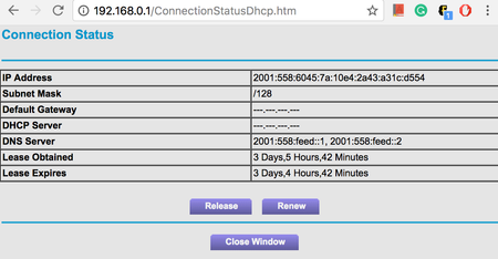

I purchased a c6300 router and registered it with xfinity. The problem is that in the router mode it never gets IP configuration from DHCP. If to switch it to the bridge mode, the connected computer receives configuration properly, so DHCP on the provider side works. I tried to reset it, restore factory settings, release/renew with no result. Using it in bridge mode as a just cable modem does not make sense for me as I am willing to upgrade to the high-speed wifi. Otherwise my previous setup of SB6121 + TP-Link N300 works fine1.8KViews0likes2CommentsMR1100 + 2 access points - DHCP address problems
