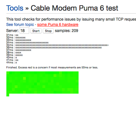

I recently replaced my Arris SB6190 modem with a Netgear CM600 due to the well publicized issues with jitter/latency on Intel's Puma 6 chipset that the SB6190 uses. One of the tools used to help diagnose this issue is here: http://www.dslreports.com/tools/puma6 Its essentially pinging a server on the internet but instead of using ICMP its using TCP. This is because some internet routers/etc block ICMP, or lower the priority of ICMP in favor of TCP/UDP. So a TCP test is more accurate. Anyways, if I am cabled directly into my Netgear CM600 modem I experience almost no jitter. For example, everything is tightly clustered around 35ms in this test: Compare that to test when my mac mini is cabled into the Orbi: The response time distribution isn't so neatly packed around 35ms - many responses are 2x that! Things I have tried: I downgraded router & both satellites to V1.4.0.18 from V1.4.0.34 - didn't help I made the mac mini the only client on the Orbi. I did this by removing power from both satellites and disabling both the 2.4Ghz and 5Ghz radios on the router in the Advanced Wireless settings. I also unplugged a switch with more wired devices from the router. At this point my mac mini was the ONLY client listed in Orbi's management inteface - didn't help jitter issues at all. Anyone else seeing jitter problems with the Orbi? This is bad for gaming, VOIP, etc. - any latency sensitive applications. I did find this other thread where somoene mentioned periodic latency issues on their Orbi: https://community.netgear.com/t5/Orbi/Orbi-latency-peaks-every-10s/m-p/1200477SolvedC3000 ping issues
