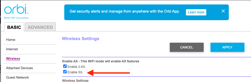

      It appears that the UI has changed since you posted this recommendation.
      A user should be able to click the "Basic" tab
      Click the "Wireless" side tab
      Then uncheck "Enable 5G"
      Please see this screenshot:

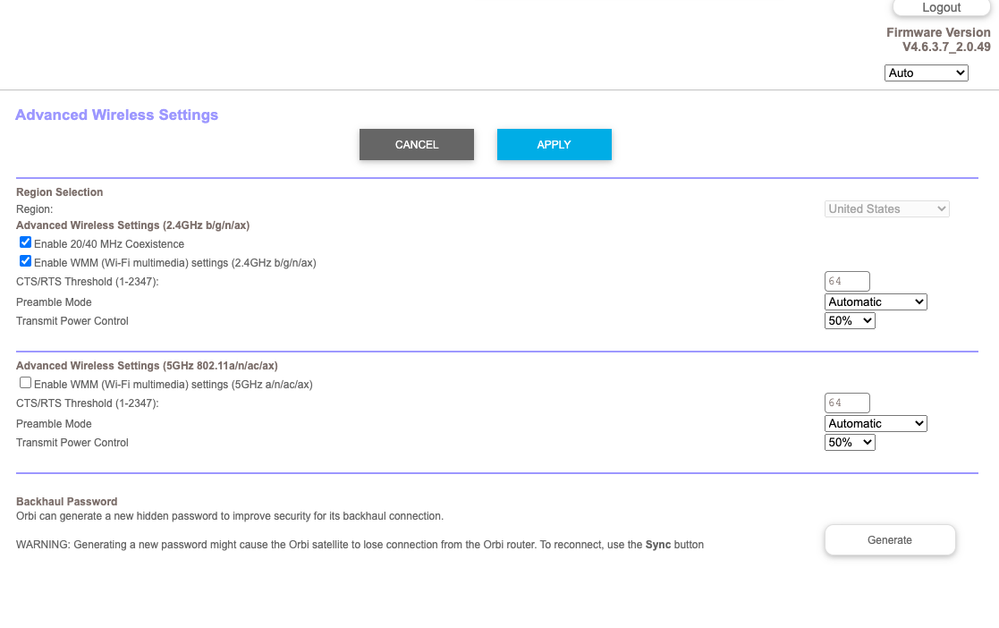

      My Orbi web admin UI does not have "Uncheck the box, "Broadcast SSID on 5G".  Here is my configuration.   My MacBook M1 which is known to have Wifi card issue.  I am trying to just use 2.4Ghz to troubleshoot.   But, the MacBook is till connected to 5Ghz.
      No option to turn off 5Ghz

        Try turning down the power on the 5Ghz radio and see if the Mac Book will connect to the 2.4Ghz set at 100%.
        What model Orbi do you have? 50 series?
        What FW version is loaded?
        You might use a external wifi bridge client device that you can connect a ethernet cable from the Mac Book to the wireless client in bridge mode too.
