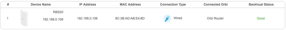

Here's my network path:
ISP Modem>Orbi router>24pt Gb non-managed switch in main closet>HP 8 port Gb non-managed switch in living room>50ft CAT6 cable to far office>Orbi Satellite<1 LAN wired PC and 1 NG wireless bridge connected to the Satellite in far office room. Connected the main network cable and tested PC. Got internet. Able to access NG wireless bridge from router side. No problems.
Sorry, posted wrong picture:
