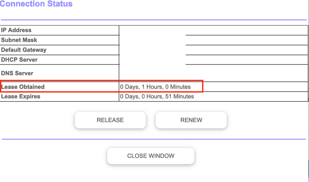

Will check internet port next time it happens,
Can you please check what lease time your ISP has in the INTERNET PORT STATUS.
- nelsonrlFeb 16, 2019Aspirant
I see the satellite is disconnected by logging into the RBR50. Only one satellite and daisy chain is turned off. I have a second satellite ordered. A couple of devices do loose connectivity when this happens. I do not see lease time on my modem, but will keep looking,
