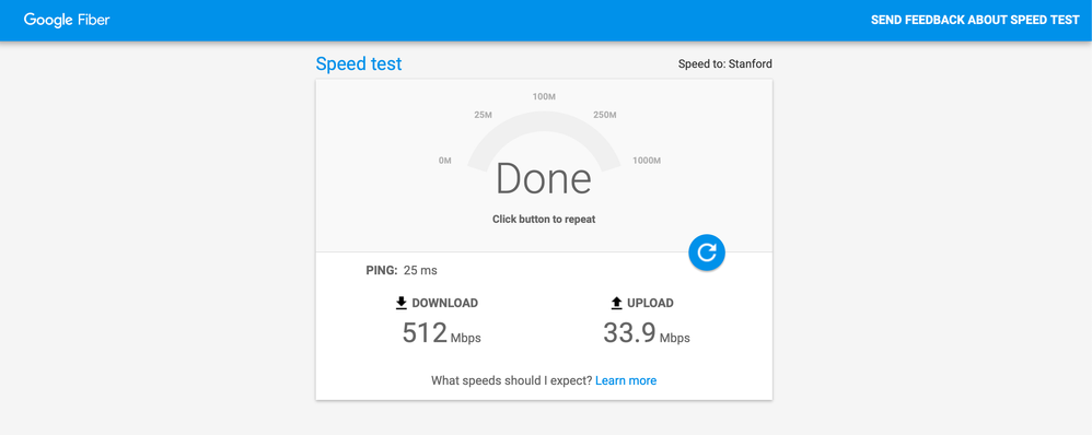

    My Orbi/Satellites performance with v44 are almost back to normal.  Download speeds from Satellites are relatively close to v210.
    • SW_'s avatar
      SW_
      Prodigy
      Wired speed (LAN) from Router is also good with v44.
      If you are still on the fence and haven't tried v44, give it a shot.  Be ready to invest time to deal with unexpected issues with your particular setup.  It took me about 2 weeks to iron out the wrinkles in my setup.  YMMV.
