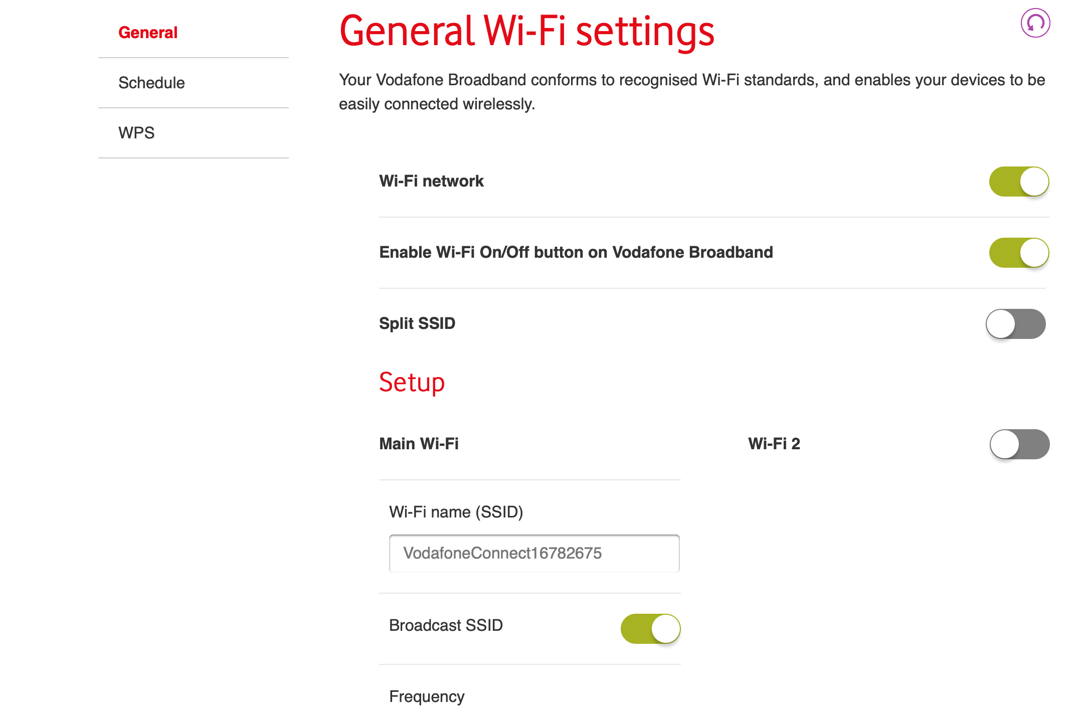

    Thanks very much for your response.  I have contacted vodafone, who advise that they router cant be used in bridge mode.  So, I have follwed your guidance and have put the orbi in AP mode. To change double NAT, I now need to change the settings on the vodafone router. I attach screenshots of the wifi settings, and get a warning to turn these off - please can I check which settings I should use with the orbi in AP mode?
    thanks for your support, which is much appreciated.

    I would switch off the WiFi network and WiFi enable buttons is all. This should fully disable the radios on the modem. Contact your ISP for further help with the modem.
    Glad you go the Orbi setup for AP mode. :smileywink:
