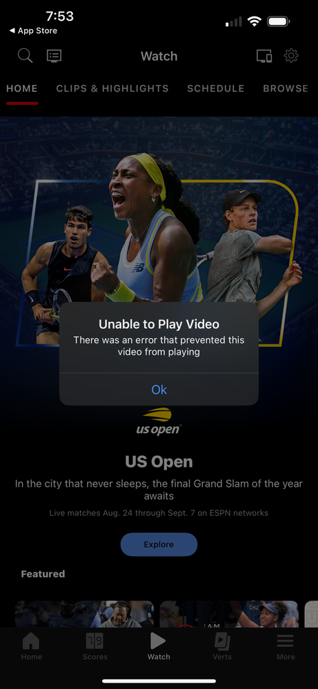

Hello,
I have an RBR50 with multiple satellites that has worked flawlessly for years.  However, now with the latest crack downs on VPN's etc. I am having issues with certain apps, specifically right now the ESPN app.
I spent close to two days trouble shooting, including on the phone with ESPN support and have narrowed it down to something within the WiFi network.  The ESPN app for refence would not work on my SamsungTV, iPhone, AppleTV, or Firestick.  However, if I disconnect my iPhone from the network it will work using cellular data.  Also, if I remove my incoming ethernet cable from the Router, and connect it directly to the AppleTV it will work as well.

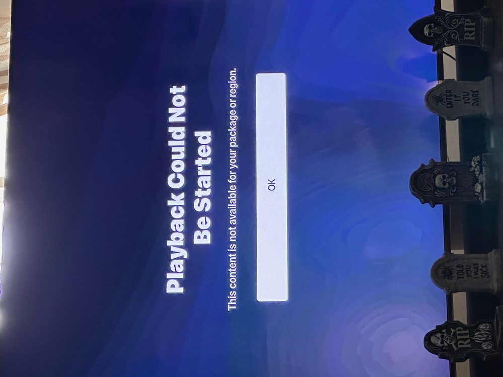

    In what way does the ESPN app not work?  Is there an error message?
    • rwd2001's avatar
      rwd2001
      Its acts as if I am not within a region that it can access when I am connected to the WiFi.  Works fine when straight to my fiber connection or on cellular
       data.
