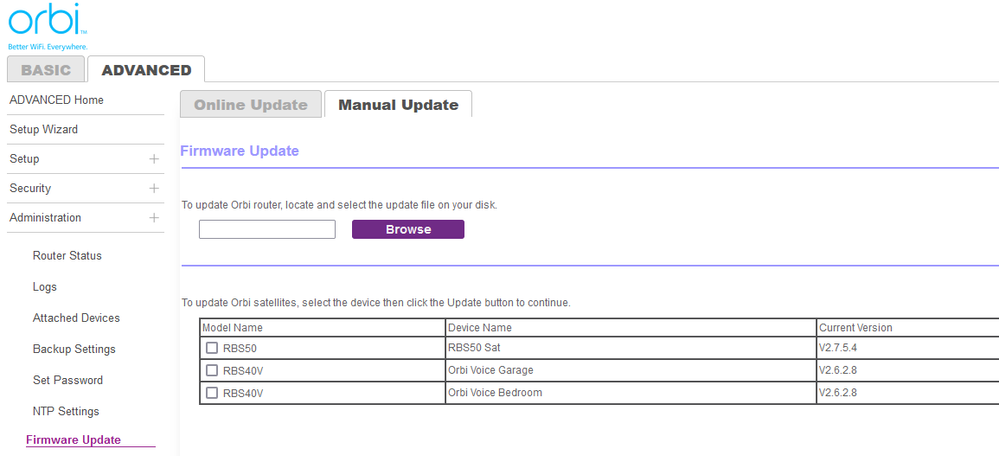

        What a frustrating situation!  The Firmware Update, Manual Update Tab is supposed to look like this:
        The panel underneath Firmware Update provides a button to locate the firmware image for the router (Browse) and an Update button on the right side of the page (cuf off in this image) to start the process.
        The bottom panel is supposed to have one entry for each satellite. Check the satellite to update and click the Update button on the right side of the page.
        If no satellites appear, then the update process is to connect directly to the satellite's Home Page using the IP address of the satellite, which appears on the Attached Devices page.  The bottom menu item on the satellite Home Page is Firmware Update.
