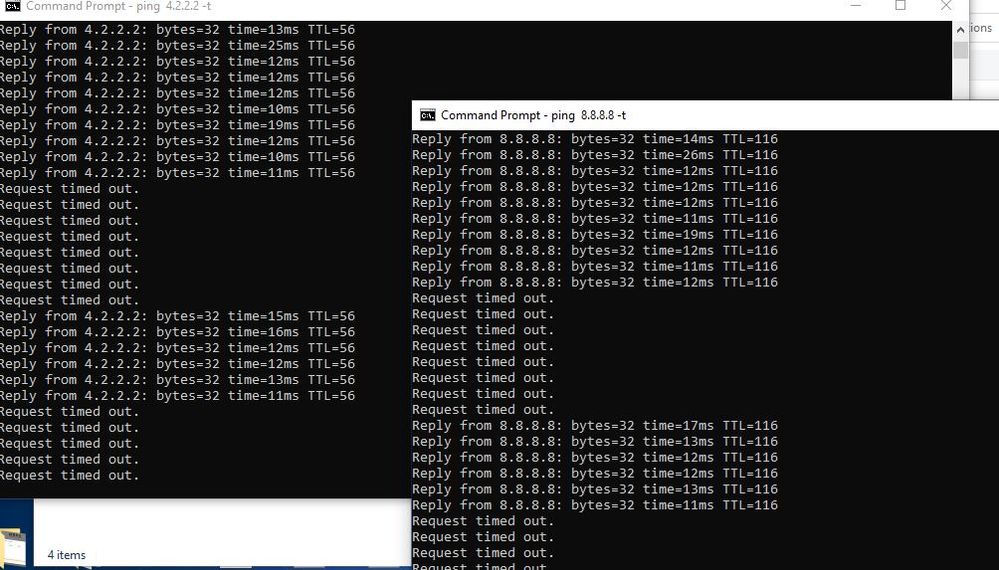

      I can watch several pings drop out and the app shows RBR50 offline.

    If I am on my phone, say for example, watching a youtube video I can see the ping on my laptop drop out (both wired and wireless to RBR50). As soon as that happens the video on my phone stops playing. See attached.
