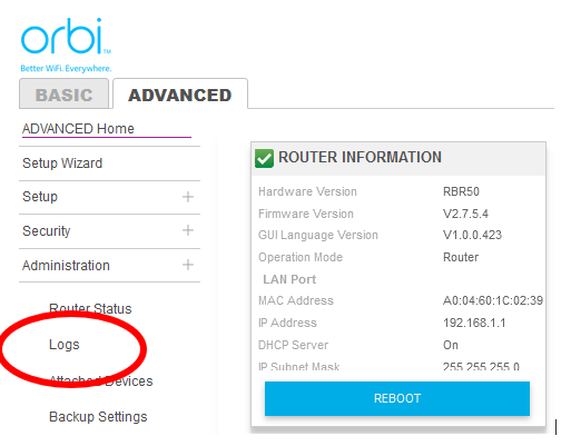

As long as the router has not rebooted, the Orbi log may give a hint to what has happened. The log is found on the Advanced Tab, Administration Menu:

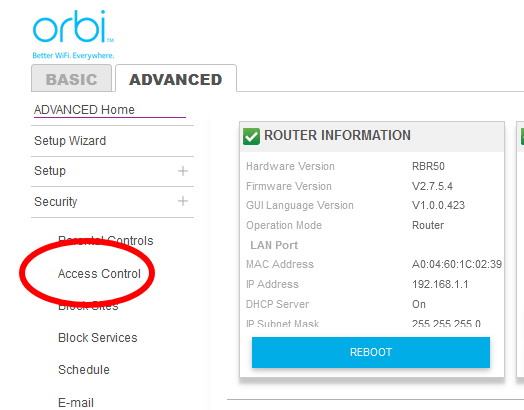

- How many devices are connected to this router?
- Have you ever cleared the 2nd and 3rd tables on the Access Control page?
(devices which are not connected)
My impression is that there is a known programming error in the RBR50 firmware which can cause problems when the configuration file gets "too big". This bug was never addressed when the RBR50 was an active product, and now that this system is "End of Service", Netgear will not spend any money fixing it. (I had the same sort of issue with my 2013 Honda. Not issuing any more Map Updates (that cost $150!). Sort of a f**k you for keeping your Accord for more than 10 years!)
