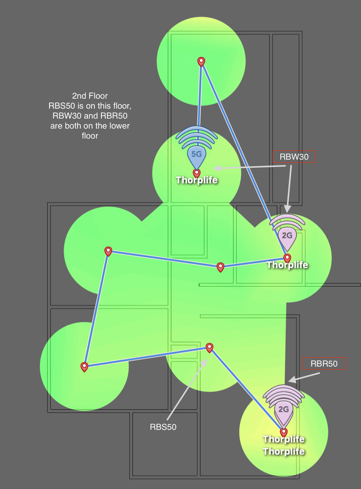

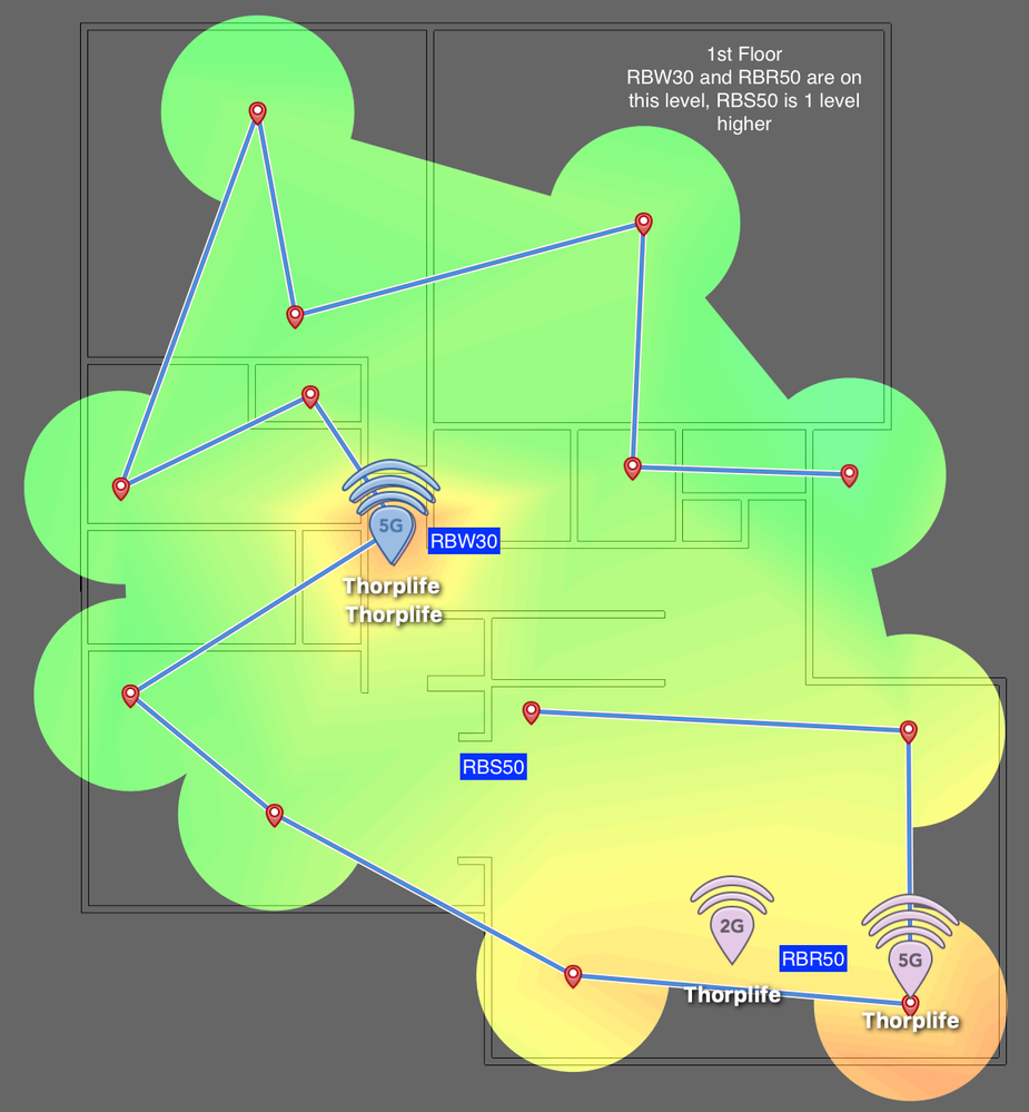

So I ran a detailed WiFi mapping of my site using NetSpot marking about 24 locations in my house. On the heat map it never see’s the RBS50 as an AP even while mapping a location within 2’ and another within 8’ of the satellite. In fact in locations one would expect it to grab the satellite as a wireless point, it locks on to the router or wall30 plug much further away. In my scan/map if standing next to the router or RBW30 the heat map goes red, but next to the RBS50 it does not register.

      Thanks for the reading link on radios. By tracking the MAC addresses using my scan the RBS50 is question appears invisible. It's not completely because I know the wired connections are working so let's say it appears wirelessly invisible to any client wanting to connect.
      I'm attaching the map results and marking where each MAC is visible. NOTE I show the RSB50 location in relation to the map but it's MAC address never shows up even when I was standing right next to it and again less than 7 feet away.
        From this analysis I can assure that there is something wrong in the RBS50 radio:
        - If it's a software fault, it should be fixed with a factory rest of this satellite
        - If factory rest of the satellite does not fix this then it has to be something wrong in the radio unit in this satellite, it can be a loose connection to the side antennas responsible for the Fronthaul network or a bad hardware.
