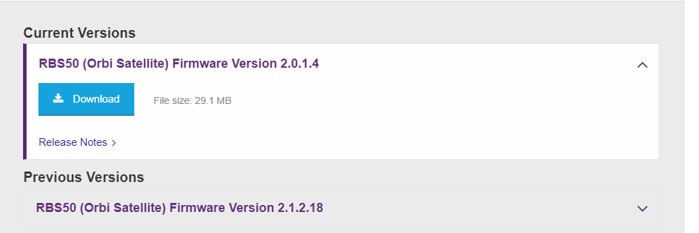

  • I'm have extactly the same problem, using firmware v2.1.2.18, it works for a little while, then satellite just stops, it seems that devices failover; contect to the router (it's in AP mode), but this has very weak wifi signal. The status info given in the UI is very poor and I haven't found any usefully log information. I've very disappoint with these units. I've reset them numrous time.
    If I go to the firmware download page, it shows v2.0.1.4 as the current version and v2.1.2.18 as previous version, HOW DOES THIS MAKE SENSE?
      Firmware 2.1.2.18 was put on hold due to the issues that people were reporting. Full story here https://community.netgear.com/t5/Orbi/OrbiOS-MR-2-1-issues/td-p/1506307

      Hello pagabv
      What Roamabout is saying is correct you are able to revert back to 2.0.1.4 if that firmware is more stable for your system than 2.1 I suggest going back if not you can continue to use 2.1.
